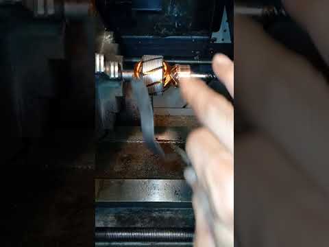

    I then cleaned the commutator using the lathe with 1000 grit paper. Then using the backside of a X-Acto knife blade I cleaned all open spaces between contacts. Then I polished both shaft ends using the lathe again.
    Jerry_HL_Motor_0029.jpgJerry_HL_Motor_0030.jpgJerry_HL_Motor_0031.jpgJerry_HL_Motor_0033.jpgJerry_HL_Motor_0037.jpgJerry_HL_Motor_0038.jpg
    Lathe work
