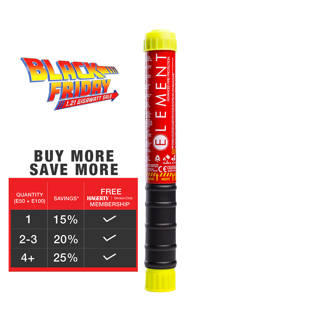

    Get an Element 50 and stick in a glovebox or somewhere else convenient, you don't need the Hot Rod Harry "show" mounts with big bottles, if you DO go that route get Halon or Halitron - these leave no residue (ask me how I know based on my dual quad fire) Ugh! Took a whole weekend to clean up the mess in the picture....this fire happened in my garage and I was damned lucky to see it before entering the house since the hood was down. Result of mounting rebuilt (by someone else) carbs I just bought and not checking things....the big fuel inlet nut was loose on the front carb letting fuel seep all over the place. Also cost me a pair of underwear.
    Our most popular model. Offering 50 seconds of fire fighting protection, E50 is recommended for professional use (automotive, power sports, garage, marine, etc). E50's extremely small and lightweight construction allow for storage almost anywhere. Internationally tested and certified. FEATURES 50 second discharge.

          But, I'm an Element 50 fan now

            I use the Element 50 as shown on Jay Leno's Garage. It lasts 50 seconds. I glued a strong magnet to the clip that comes with it. You can then mount it to the Bird cage where your VIN/Trim tags is.

              I'm not familiar with Element 50 and will have to check into it. Jay Leno is a good guy.

                        Re: Fire Extinguisher Recommendation Wanted
                        https://elementfire.com/products/element-e50
                        Has anyone used an Element E50 in a real fire? Or has found a testimonial or video showing it in action with a real car fire? All I can find are demonstrations. There's a lot to like: small, no residue, 50 seconds of discharge. But after watching several videos it looks like you need to get close to the fire (1 to 3 feet) to be effective.
                          This guy seems a good bit farther away than 3 feet: https://www.youtube.com/watch?v=GwzZJInS40g
                          With a regular ABC bottle type, I was just as close as this guy when I put out the fire on my 61 (in the pictures above).
                          Having said that, at some point, if the fire is extensive enough, your best bet is to move off and have the pros deal with it.

                            I'm just learning about E50. I had always carried Halon extinguishers though. One saved my '59 in Manchester NH years ago on a hot August Saturday. I didn't do a video during the catastrophe though... lol. No smartphones then.
