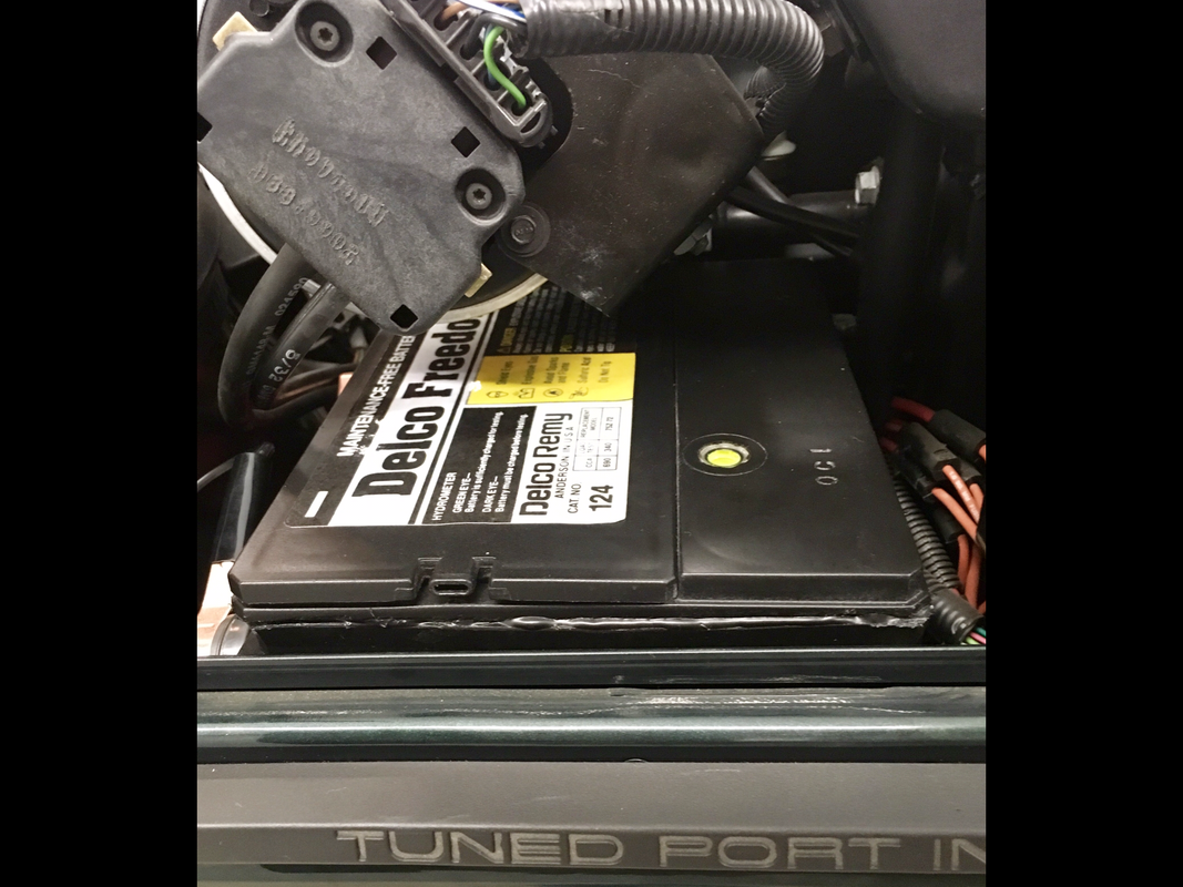

Hey joe I have been deciding which car to have judged at the national event. My charcoal metallic did very well at the regional event scoring 99.6 but I am leaning towards bringing this 93 . Having bought this car also from its original owner , that owner is sending me the original battery that came out of the car. I understand there is a process to place a smaller battery inside this original casing ? How is this judged ? As obviously it cannot be the original battery but will just appear original. Should I pursue this ? The leaf spring bushings just have some splits in them due to age of course. They still seem to function perfectly as the car is very tight and rattle free. I will leave them in place so nothing has been touched on this car . Please advise about battery when you can.- Top

Batteries are judged by Standard Deduction Guideline #2. An undetectable or Original battery would receive no point deduction for Originality. Condition is judged separately. "Green Eye" battery health monitors may be problematic to make appear working. Judges are not going to disassemble a battery in any event.
That said, SDG#2 assesses a 50 % deduction on a correctly sized DELCO service replacement with appropriate top or side post configuration. Expect for you this would be a ten (10) point deduction. (Offset by 10 bonus points for NCRS sticker, battery cut-off, and fire extinguisher.)
There are 4500 total points in Flight Judging.
You'll have to decide if cost of "Original" battery (smaller battery in original case) vs Delco replacement is worth 10 points. Also, remember "Green Eye" needs to appear functional.
Dave
My personal feeling is SDG#2 is a money-saving gift to owners.Judging Chairman Mid-Way USA (Kansas) Chapter- Top
timothy------
I would never get involved in one of these "original battery restoration" operations, especially if the car is a driven car even if miles were very modest. For a PURELY "trailer queen" it might be OK. Of course, as far as "trailer queens" are concerned, I'd NEVER want one. EVER.In Appreciation of John Hinckley- Top
