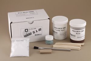

                  I use this as well as a different epoxy, but it comes in both black and brown:
                  Pro-Bed 2000 The ultimate epoxy bedding compound! Epoxy or glass bedding has been popular for many years as a tool for accurizing rifles of all types.  Accuracy depends on shot-to-shot consistency.…
