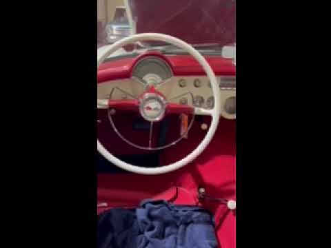

Edit:10/27 - It went back in the car today. It works. The engine is missing a few vitals so it can't be run just yet, but I suspect when it runs and the generator is in charge mode, the electrical system voltage will be in the 7 to 8 volt range, similar to my bench test source supply. I'd expect the flash rate to be a bit faster. If you turn up the volume, you can even hear the .... Ting...Ting...Ting of the flasher in its Park Brake holder bracket. I like that sound.
