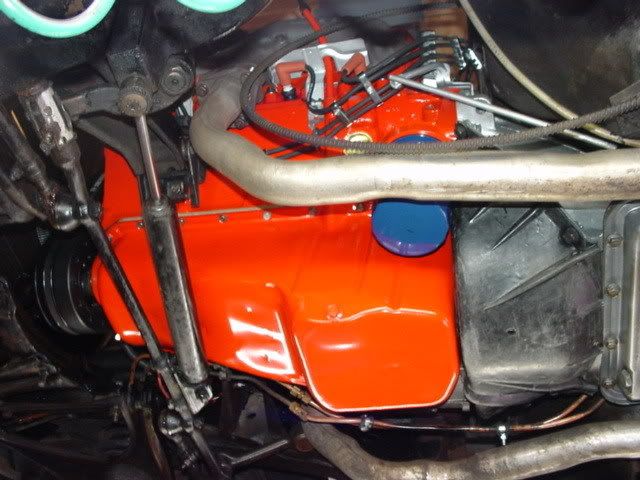

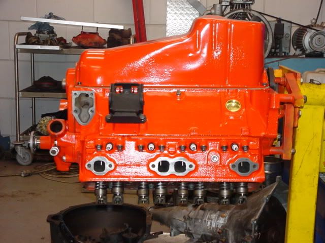

    yesterday evening i was reading a new book on the C2 and saw some pics of the pans at a 65. The pics gave me the impression that the distance between the steering bar/rod is bigger then at mine. So I get the feeling I might perhaps have the wrong pan, causing it to damage and leak. Below some pics of the pan and the distance between pan and rod.
    The pan
    The distance, you can see the dents. Now it is worse!
    the block is a 327-250 HP, any of you have some advice? I want to order a new pan, so what is the correct one?

    The oil pan on your engine is not the correct oil pan for a mid-year small block.

            Oil pans of the external configuration seen in your photos were used on Corvettes but ONLY if you have a 1975-79. They were also used on MANY other Chevrolet models dating from the mid 60's.
