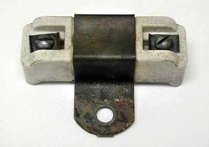

      C1's and C2's used the same 0.3-ohm ballast resistor (#1931385) through January, 1963. In early February, 1963, 250-300hp cars changed to a 1.8-ohm ballast resistor (#1957154) to reduce point-burning in cold weather.

        1955 only Corvette or Car first design

          the ballast resistor in your picture(roy b) is not 55 only as your post states.. that configuration of the porcelain is what i like to see on the 56 and 57 vettes.mike
                I'll say your correct ,my brain is on 55. This ballast first design is rarely ever seen. I depend on you after 1955 ,cant afford those newer $$$ Corvettes
