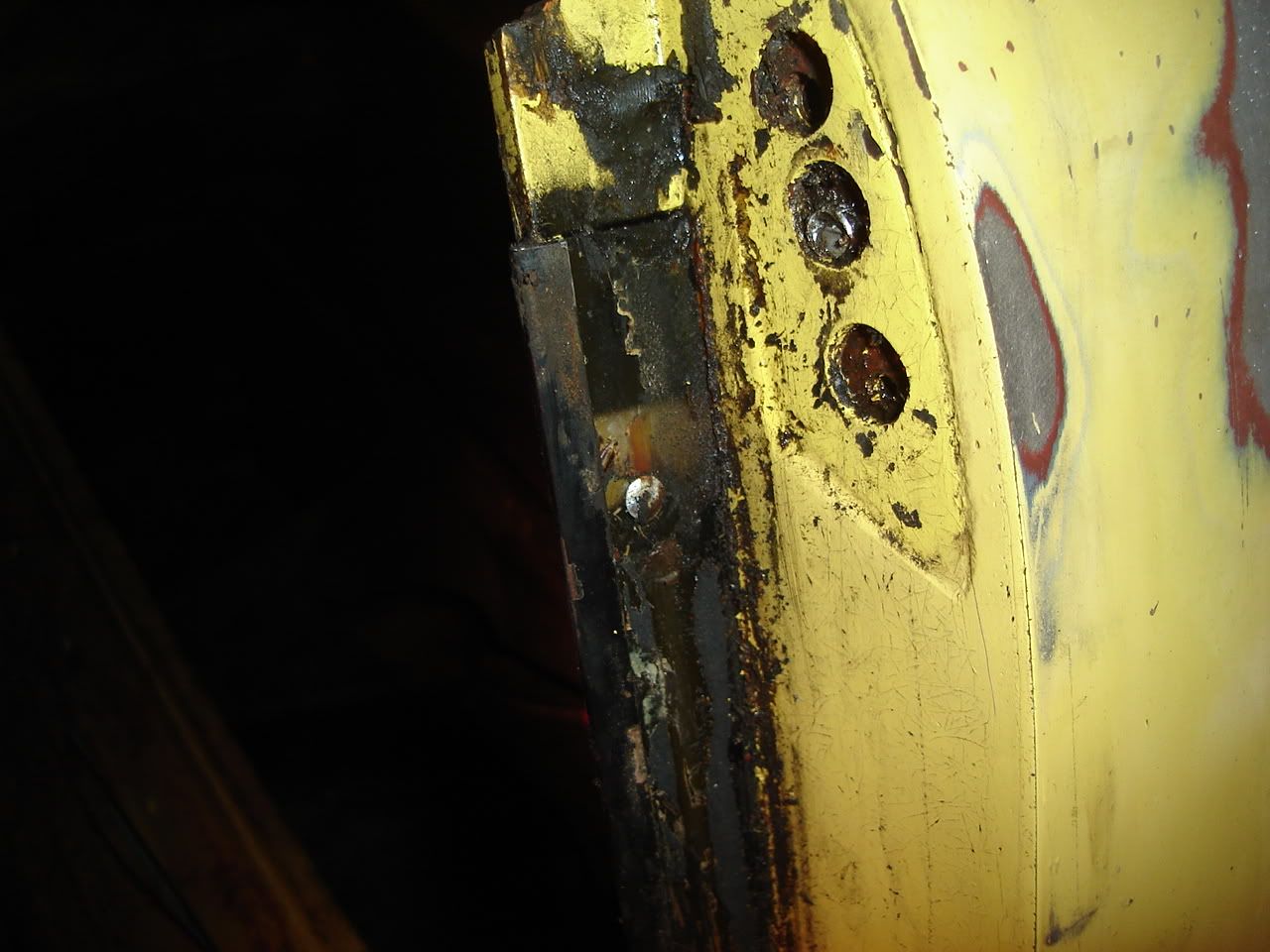

    I knew better but kept turning it. Any ideas how to get it out? It is in the adjustable plate the t-top thing with the triangle stud screws into. I don't see any way to get the plate out from behind. Its a 70.

            Is there any way to get the plate out? May be tie a smalll wire to it and let it drop down and out a hole then pull it back up. Is it in a groove or what I know it moves for adjustment but what keeps it from coming out?

                    The easy out extractor won't work. The thing broke off is a craftsman left handed threaded extractor that tightens up in the hole and grabs. Nowhere for the fingers to go in. If any one knows what holds the plate in. That may help figure if I can get it loose. Anyone maybe parted out one to the point you can see in there? Pics would be nice. Thanks

                              I put the screw in the lower hole and a bolt where the triangular shaped stud goes to hold it and pecked at it with small punch trying to turn it and no luck.
