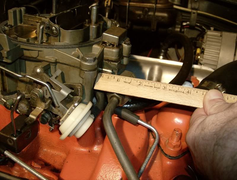

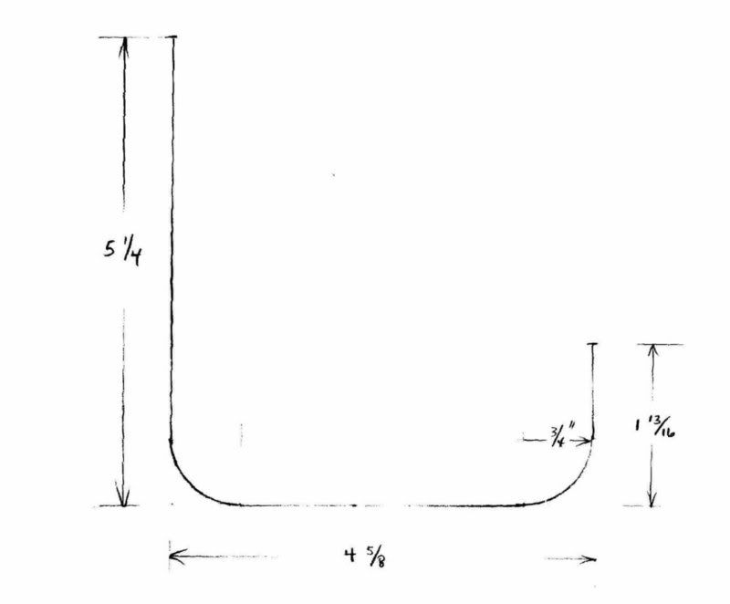

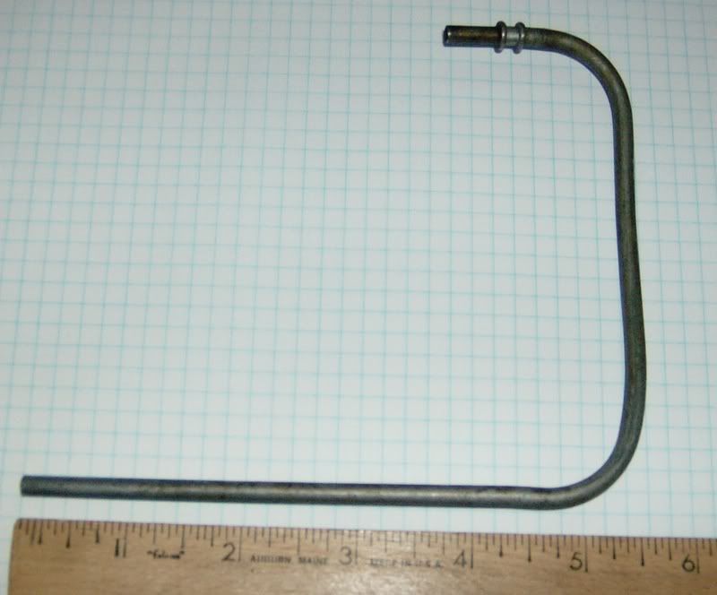

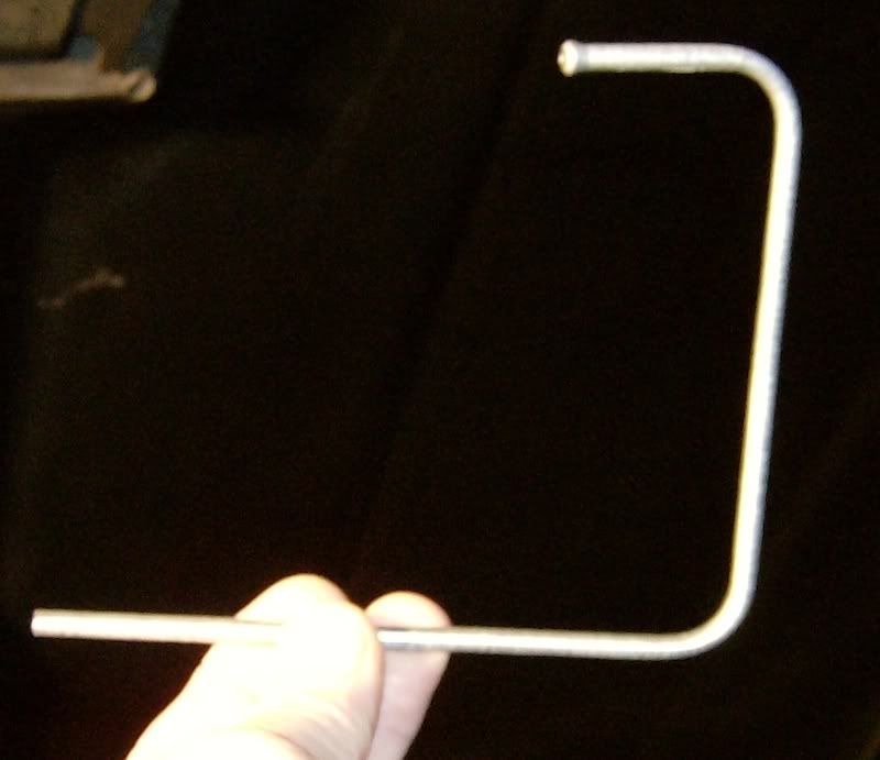

The advance tube fits loosely, but seals quite well. Have no problems. The diameter of the advance tube is the same as the diameter of the metal tube on the front of the TCS solenoid. The hose there is the same diameter as the one from the carb to advance tube.(see my photo obove in the post)
The hose does expand enough to fit that larger diameter tube on the carb. In fact, took a real effort to get the hose off the carb.
