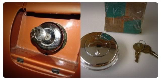

      Many cars used the same cap and there filler neck was designed different then Corvette so you cant use a car gas cap, (any year) it might have been listed wrong. Because as many people have found out people steal caps ( isn't that nice) so I installed the dealer accessory locking gas cap as seen here that fits ONLY Corvette C1 and install the original only when doing the NCRS thing . Remember many parts are listed by part number which means little if you don't know what the part looks like.
