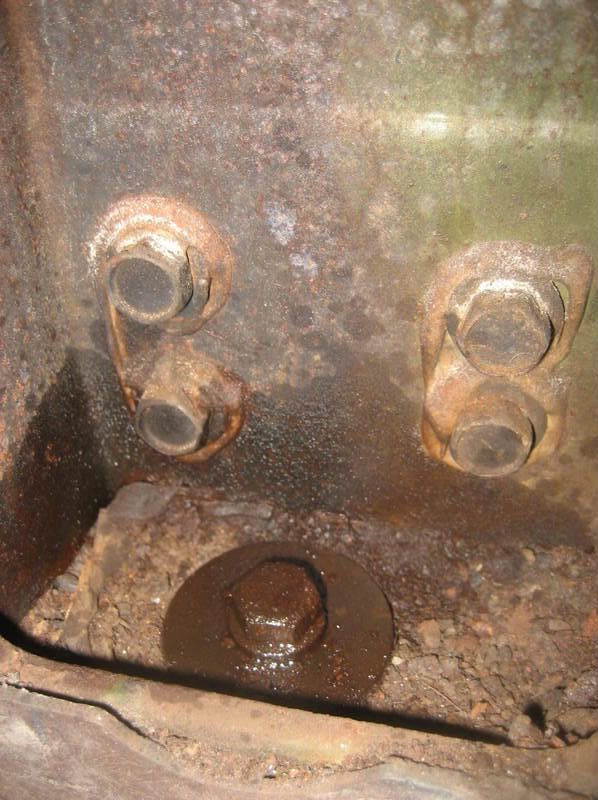

    Today Rob and I worked hard to lift the body from my 68. However, we were only partly succesful. Body mounts #1, 4, 5 and 8 are out - so far so good. However, # 2, 3, 6 and 7 are still in place for various reasons and for which I would like to hear your opinion. Needless to say the bolts were sprayed with WD 40 etc in the prior weeks.
    #2: (the one behind left interior panel) can't move the thing EVEN with power (air) tools.

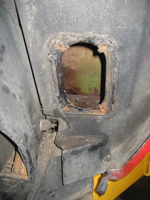

    #3: (the one behind the cover in the wheel well area) - damaged bolt - bolt is round and tools won't fit.
    #6 (see pic - the one behind right interior panel) - the bolt spins without coming out - cross threaded or...., but in any case spinning without moving.
    #7 (see pic) - same issue as above. Spins but is not coming out.
    Question: how to deal with this. The problem is that especially in the wheel well area you cannot access the bolts that are behind the cover to file. Obviously I am reluctant to cut part of the wheel well area to gain access. And even # 2 and 6 are hard to reach.

        thanks Jack, but how to you gain access to the 3 and 7 bolts to cut/drill?
        • Steven G.
          • November 17, 2008
          • 348
          Re: Spinning body mounts that are hardly accessible
          I have same situation, I have decided to oxy/acy cut off bolt heads using shielding + wet rags in front of rear wheel mounts, the rear mounts unshielded should be fine, I am sure to do body mount repairs due to rust and have lifting straps placed in hopes to use a cut off wheel if the opportunity should arise unless all rot and just lift as is. Steve

              Those spinning bolts suggest to me that the captive nuts have come loose, spinning in their retainers, so no amount of WD or other will help much with that. I don't recall there being enough clearance to sneak in from underneath to grip the nuts. I believe a well handled die grinder, and some patience are the answer as Graeme suggested. Using heat to free a spinning bolt will not help, and only endanger the car.
              So a die grinder with a burr, or a small cut-off wheel to take off the bolt head.
