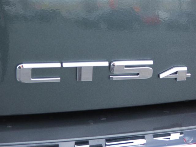

          Re: Anybody Ever Saw a Perfectly Overrestored Vette?
          Here's a picture that makes it clear about orange peel in the paint. I just wasn't willing to have orange peel in my paint job that cost most of what my one year old Subaru did a couple years ago.
          A 2009 Cadillac CTS4 in the first picture, and my base coat/clear coat red 67 in the second and third pictures. Can you see the car in the reflection of the Cadillac paint job? How about the leaves on the ground in the reflection of my paint job.......exactly.
