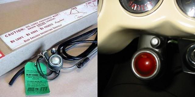

I've shown it before but people still have never seen one.Have had it in my 55 for years
You need it in your 60PG- Top

Interesting gizmo Roy, never seen one like it before. Hope it never decides to spring a leak into your lap!
