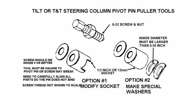

          If I remember correctly, if the tilt spring cap has a rectangular hole use a regular screwdriver. Insert it into the slot push down and rotate the cap to disengage it. If the cap has a square hole, use a the appropriate size phillips screwdriver.
          To remove the pivot pins:
          Another method to extract the pivot pins would be to thread a 8-32 screw into the end of each pin. Grip the screw with a slam puller tool. A few quick raps should draw the pin right out. Using that same 8-32 screw you can try prying the pin out of the bearing housing using the claw end of a hammer (protecting the column parts with a piece of wood where you leverage the hammer.)
          Jim
