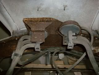

        It ain't pretty but this is an untouched 70 front clip. This the relay you mean?

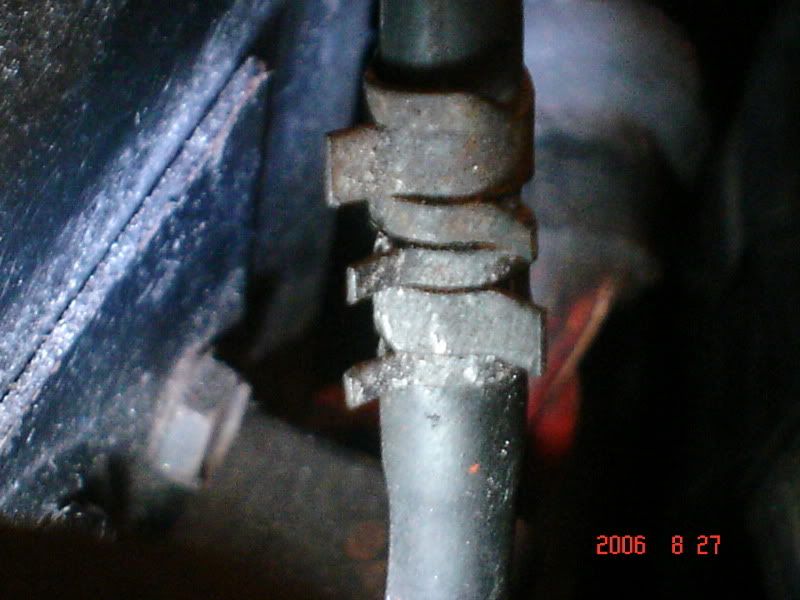

              Here's the connector from the discussion....
              found the clip pic. Not on the tee but I think its on that line and same type clip.

                Ah Ha! Go find another of those. Good Luck.

                  That is the connector and those would be the valves!

                    Those are the headlight valvs, and they are under the nose between the headlamps on ALL 1968-1973 (and I think some years later as well) Corvettes. There was only one relay in 1968 and most of 1969, but then they added a second relay for faster headlight response.
