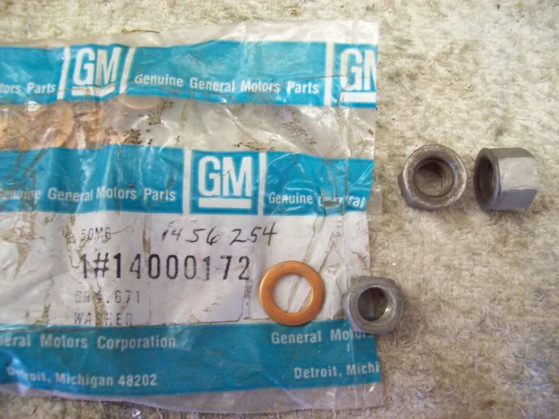

            Ummmmmmmmmmmmmmmmmm, I'm thinking that there is NOT supposed to be lockwashers between the nuts which attach the rearend center case to the axle housing!
            Early cars (up to about 57, Vettes and pass cars) used copper washers under the nuts, and later cars (58-later) had nuts with swedged-on or integral steel washers. The purpose of these washers was crush/conform to the irregular cast surface and create a seal around the studs to prevent oil from weeping around the threads and leaving a film of rearend oil on the axle housing.
            That's what I have personally observed on UNTOUCHED cars (pass cars and Vettes) for MANY, MANY years.

                • Tom P.
                  • April 1, 1980
                  • 1814
                  Re: 1962 Rear end torque specs
                  Pictured here is a pkg of original copper washers as used under the rearend nuts on 57-earlier cars to seal to prevent rearend oil from weeping around the stud. The hand written part number is the ORIGINAL GM part number for the washers, the number on the pkg is the superceeded part number. BOTH are discontinued now.
                  The 2 nuts with integral swedged-on washers on the upper right are what I have pulled of of MANY 58-64 cars.
