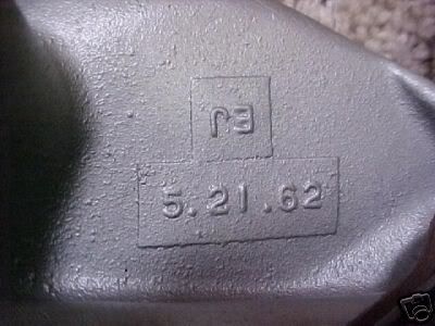

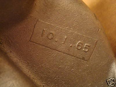

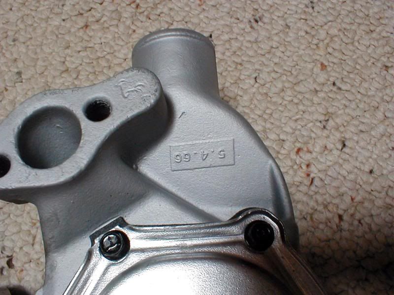

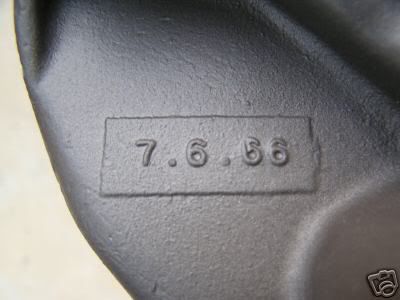

          I can't read the part number on the pump but if it is actually 3824059 that's about a 1963-issued part number.
          The presence of the second, upward facing, threaded boss is a conclusive indication that it's a 3824059. No other pump that I've ever seen is so configured.
          The earliest one I've seen was cast in '62.
          There were lots and lots of them made in '65 and '66.
          I've never seen a pump cast in '64. It's as if a few might have been made for the Grand Sport program and then, as an afterthought, they were made available over the parts counter in the mid-'60s. I don't know this to be true, but it's entirely consistent with what I've observed..
          Jim

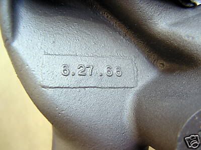

          • Peter J.
            • September 30, 1994
            • 586
            Re: 64 Aluminum water pump #3824059
            Jim,
            If I had the one dated 6/27/66 on my 66 L-79 that sure would make a fun judging session.

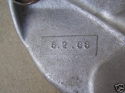

            • Jim L.
              • September 30, 1979
              • 1805
              Originally posted by Peter Johnston (25176)
              Jim,
              I can appreciate the humor in this.... it'd torque the meaning of "matching numbers" somewhat.
              Unfortunately, the date can't be easily seen once the pump is installed because it's on the back side of the casting:
              Jim
