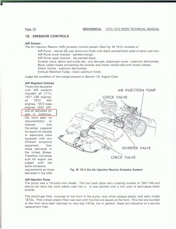

    An d where does the TIM&JG say that NA9 has AIR?

      Re: L46 Choke Rod Help

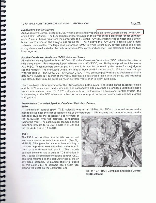

      Wouldn't all California cars have the NA9 option, thereby also having AIR?
      The manuals are at times confusing. Rather have you set me straight

        #18
        AIR is NOT associated with NA9. NA9 was 1970 only and consisted of a different carburetor (vent on primary bowl, and numbers listed in the TIM&JG) and carbon canister. NA9 also consisted of the aluminum plate under the carburetor and insulating washers for the carburetor mounting fasteners. I will say again, NA9 had nothing to do with and Air Injection Reactor. Is that clear? I don't know how to make it any clearer.
        All California delivered 1970 Corvettes were supposed to have NA9, but it was available anywhere, and I have surveyed more than a few 1970 Corvettes that were delivered to locations other than California with some or all NA9 equipment installed. I have also surveyed some 1970 Corvettes that were originally delivered to California residents that did NOT have NA9 equipment installed.
        Dennis your problem is in this statement:
        "Wouldn't all California cars have the NA9 option, thereby also having AIR?"
        You take it that NA9 = AIR. That is NOT true. End of story. Now you have to try to believe that statement, and accept it into your heart.
        You are not satisfied that the TIM&JG makes NO connection between NA9 and AIR. You want personal service. Now you got it. The only thing further I can do is to ask you to put your handkerchief on your computer and pray for enlightenment. I can guarantee you, if you send a sizeable donation to Day Road in Cincinnati we will see that you reach the light that surpasses all understanding.

          #19
          You have to bear with me I'm a little slow.Still looking for the"any key" on my keyboard
          I get that AIR is a seperate system fron NA9. The AIM&JG states the AIR on all california cars. Also states the NA9 on all California cars. I don't know, kind of made me think California cars had them both, go figure. Thanks for clearing that up.

            #20
            Dennis the second page you boxed refers to 1972 California Delivered base motor cars. NOT 1970. You can not extract a part of a sentence and make it say something out of context. At least you can not do that and be correct.
            And yes the first statement you boxed states that ALL 1970 California delivered Corvettes had NA9. THAT was the California law, and is Chevrolet's story.
            On the judging field if an owner shows up with a California delivered 1970 Corvette without NA9, it is the owner's responsibility to satisfy the judges that it was delivered without NA9. Of course the reality is the owner simply would not tell us the car was delivered new in California, and we would never know. Easy peasy, lemon squeezy
