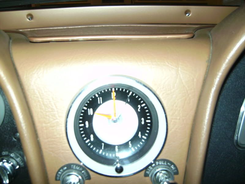

              A January dated 63 clock.

                I wonder if anyone ever figured out when this change occured for the 63's? Mid production? Early?
                Harry, have you ever noticed that the speaker screen around the defroster opening is warped/bent up in the center on most/all 63's? It looks bent on your car too.

                  Michael, yes it's bent as you noticed. I don't like it, but that's the way it will stay.

                    Yup, it's correct/original.
