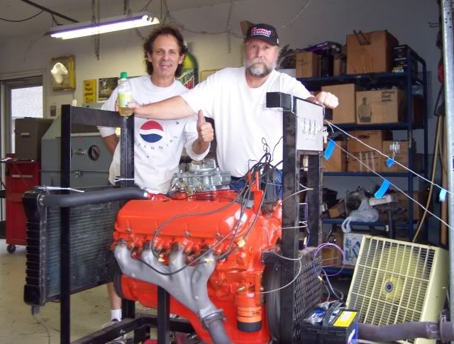

          That was my understanding when I was researching the rebuild of the engine that 1965/66 were unique in their oiling system. This all changed in 1967 as you've stated. The engine/car originally came with a TI distributor however was not in the engine when purchased and as stated had a SB distributor. Intial start up and break in was going to occur on an engine stand makes it challenging to wire up a TI distributor which happens to be a BB distributor. Didn't want to incur any damage using a SB distributor and so as Joe stated I was good to go.
          All went good last Sunday as engine was started and run 45 to 50 minutes with minimal amount of "heart burn"! I'm the proud pappa on the left.
