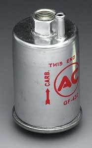

          The line on the passenger side is a FUEL RETURN LINE. For 1968-69, this line originates at the nipple on the top of the GF-432 fuel filter. All 1968-69 Corvettes with Q-Jet carbs were equipped this way. Holley carb engines were not so-equipped. There was no in-line filter and there was no passenger side fuel return line.
          1970+ Corvettes all used a passenger side fuel return line EXCEPT 1970-72 LT-1. However, on 1970+ Corvettes equipped with the fuel return line, the line originates at the fuel pump. These applications used a long canister style fuel pump with 3 ports---an inlet, outlet, and fuel return line.
          I would be very hesitant to "cap off" a 1969 fuel return line. However, there were many non-Corvette applications with Q-Jets that did not use a fuel return line. So, presumably, a Q-Jet will work ok without such a fuel return line. Still, I'd be very reluctant to try it.

                Re: New gas tank problem on 1969 350
                This is the GF-432 fuel filter.
                You could try to change it to a filter without the nipple but I think it is there for a reason, and besides, that would go against my creed. If you don't have time to do it right the first time, when are you ever going to find the time to do it over?

                    • 43193
                    Originally posted by Fred Close (50580)
                    Thanks Joe,
                    If I replaced the gf-432 with a filter that does not have a return port, would this not work for me?
                    fred
                    Fred----
                    Yes, it should work. However, you'd be sacrificing whatever functionality that the fuel return was supposed to provide. Among other things, the car will be more susceptible to vapor lock.
