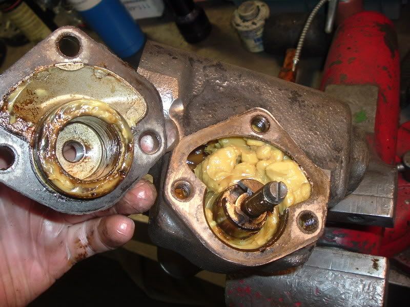

    Here is one that was over greased and leaking, you can see the new grease sat on top of the old mud.

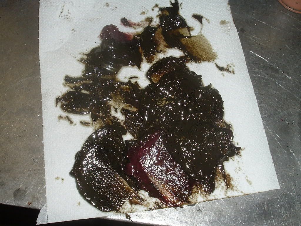

    Here is another one where the new grease(red) was pumped in until seen and when I got it apart it wasn't mixed and did nothing but give false peace of mind.

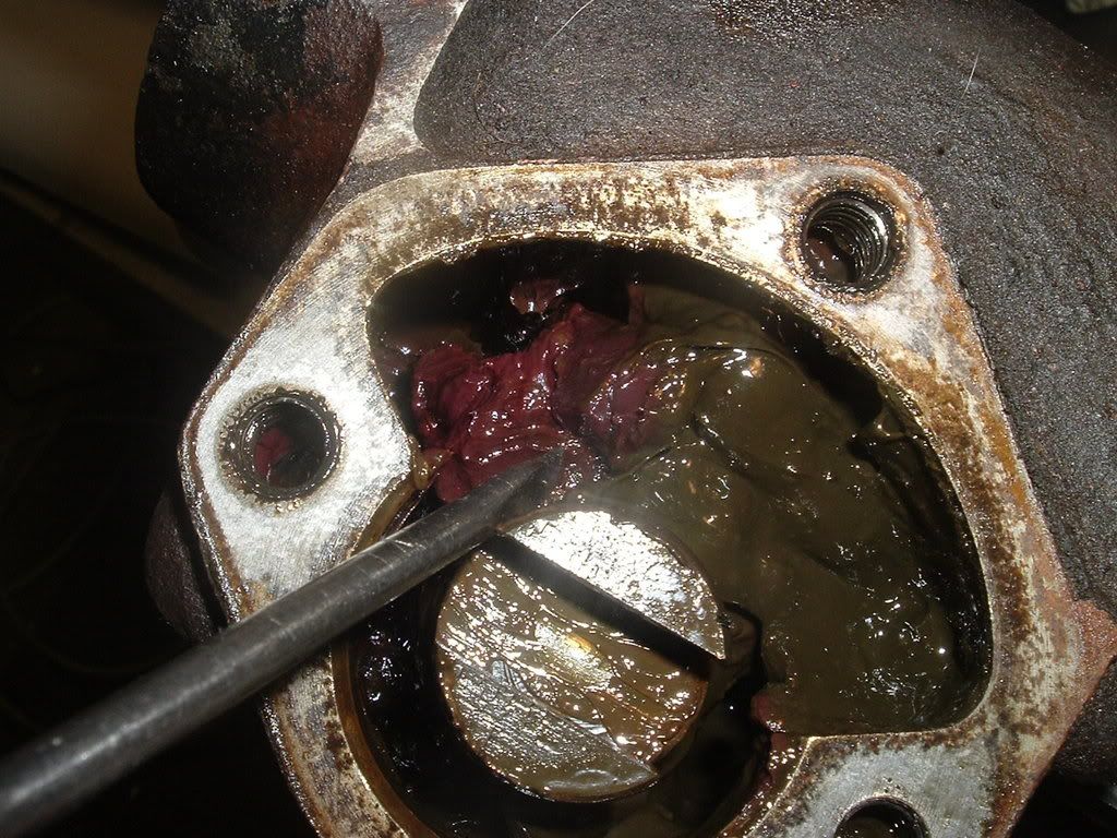

    Here is one with the end nut off, you can see that old stuff is caked in tight.

              Gary -- Nice pics; the first two look like brain surgery. Good
              recommendations; as summer is so short, gonna use the grease fitting to ensure that there's at least something in there, and maybe next winter do an R&R.
