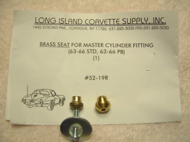

The existing brass seats were a little dinged up so when I was ordering parts a few years ago I purchased new ones from Long Island, part #52-19R, listed for 63-66 STD and 63-66 PB. Tossed them in the drawer with all the other parts at that time. Yesterday I figured I'd install the new seats. Got the old ones out and then...realized that those replacement seats are larger than the ones in my 65 MC and won't even drop down into it.
I know the basic difference is that 65 PB units used the smaller 3/16 brake lines while the 66 PB's used the larger 1/4-size so I'm guessing that these replacements are for the 66 PB versions.
Anyone know of a source for new brass seats for the smaller sized 65 power brake master cylinders?
