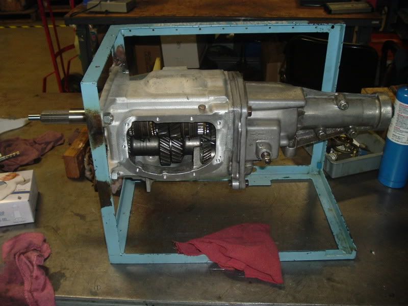

                Martin is correct, the ST-10 was used in 75's but carried the M codes used with the earlier Muncies. The 68? started with the VIN stamped in them along with prefix code to denote the ratio. I would have to go back and look this up to confirm the year and coding but you can find it easy enough online.
                If the trans is out of the car the input grooves also will indicate WR or CR.
                The ST-10's have a better 1st gear as well to run lower numerical gears and aid in fuel economy (didn't help all that much)
                Here's the BW ST-10 M20 from my 75. Good luck I like the base 75 coupe a lot, just purchased a very nice original one today in fact.
