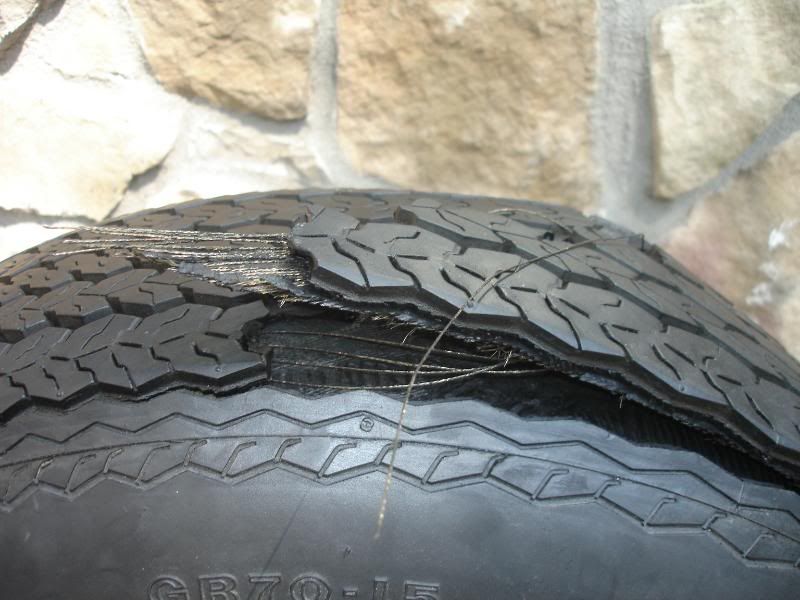

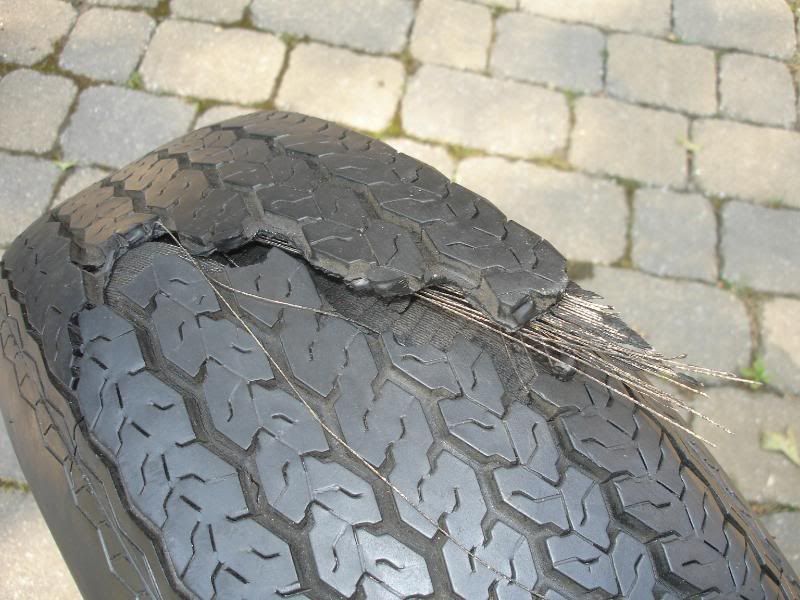

    I have original Firestone 500 GR70-15 radials that I use only for judging on my '73. As most are aware, these tires were recalled long ago.
    I happened to have one in my spare tire tub when I heard a loud pop from the back of my car. I didn't think much of it, figuring I just ran over something in the road. Well, the next time I dropped the spare, here's what I found ...
    Needless to say, this is graphic evidence that it's not a good idea to drive on old tires. The darn thing exploded just laying in the carrier. Imagine if it was mounted on the car!

    A friend who has (maybe had, it was up for sale) a 1974 with something like 400 miles on it found one tire that looked like that, but it was on the car. It expires while the car was in storage.

      Two of mine split a sidewall back about 1974. One had the wires poke through the rubber something like the picture about 1980. Then, I ran over a lump of snow which caused a bulge in the sidewall. The last one I still have.
      I had grief from the Firestone rep over the ones with the slits. He claimed someone slit the tires, but the slit was always on the inside and was near impossible to slit with a knife. They replaced those ones, pro-rated.

                  Guys, back in 1973 I worked for Firestone as a salesman in one of their retail stores. I still remember the "Steel Radial 500". There were lots of problems with those tires having the belts separate and the tire just disintergrating while driving down the road. I personally did a number of tire adjustments on Steel Radial 500's. At times I almost cringed when a customer drove in with a set on his or her car as I knew a tire adjustment was coming. I later had a friend who bought a new '77 Corvette. Unfortunately it came with Steel Radial 500's. One day while driving home from work the right rear tire disintegrated. The right rear quarter panel looked like an explosion had taken place and ripped it from the rest of the body. Unfortunately my friend had the passenger window rolled down and chunks of the tire came in and injured him. Luckily it was nothing serious. All of the tires were replaced and I believe (if my memory serves me right) that Firestone paid to have his car repaired. I do not own a 1973 to 1977 Corvette. If I did, I would have to take a hit on judging rather than run Firestone Steel Radial 500's that I consider unsafe. Brooks Glover (2141)

                      I too have a set of the Firestone 500s, but just for NCRS judging purposes. They are on the car and on the ground from the trailer to the Judging Field and back to the trailer only. The rubber on the tires are as hard as cement!. And per one of the messages on the board demonstrates, the tires don't have to be on the ground and rolling. They can still blowup just sitting in a spare tire tub!
                      Because most the tires were probably retrieved by Firestone on the Recall, if you can find a set of these tires, that is going to make them more expensive to obtain.
                      The tire does judge perfect for originality. Zero deduct. Just condition to consider.
