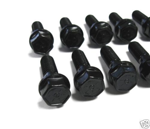

    In the past, I know several of you have had to endure the pain of some tyrannical Mechanical judge deducting points for lack of these 'shouldered' bolts at the L and R outer attaching points on your big block Corvette. They are fairly difficult to locate and I have been on the hunt for quite a while.
    I stumbled across a set of aftermarket ones recently on Ebay and wanted to let folks know what I discovered. I purchased these and was pleased with the configuration including the head marking. They are painted black, however, most would expect them to be black phosphate, but, that can be remedied.
    I have no affiliation with the seller, The Parts Place, Inc., but wanted to let the membership know, IMO, these are a viable alternative if originals cannot be procured.

    Mark are those the tri-lobe locking bolts?

      I'm not sure what you are asking, T Mac.
      Are you asking if they are a design that combines the excellent chemical, thermal and plasma resistance of perfluoroelastomer parts with a unique cross-sectional shape that eliminates many of the problems associated with semi-dynamic seal applications using a dovetail groove? :-)

        The exhaust manifold end bolts, beginning in 1968 or 1969 have a threaded portion that is not round. It is shaped like three lobes. Somewhat like a three leaf clover. The purpose is to jamb the threads into the round tapped hole so no lock washer is needed. Thus the term: tri-lobe locking fastener.
        Joe Lucia has described this unique fastener in the past, and it along with the flanged head identifies these bolts. Of course once installed all that is visible is the flanged head.

          Terry,
          You have remined me that I am but a grasshopper...trying to ****** (now that's funny, I don't care who you are) the pebble from your hand.
          These are NOT tri-lobe but, once installed, could not be distinguished from.
