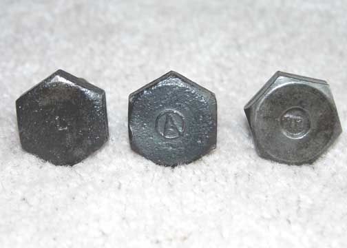

                    Fasteners, like most of GM's purchased parts, were almost exclusively sourced from multiple qualified suppliers. It was a NOSEBLEED exercise in salesmanship to get a sole source qualification for a purchased part!
                    The headmarks I've seen on these oil pan plug bolts include: A, Circle-A, L, TR and F-C. I'll bet there were others as vendors were known to change their ID marks and some suppliers got out of the business while others entered over time...

                      Re: 67 Oil Drain Plug Question
                      This picture was posted either on this forum or the Corvette Forum. I saved it to my computer as a reference.
