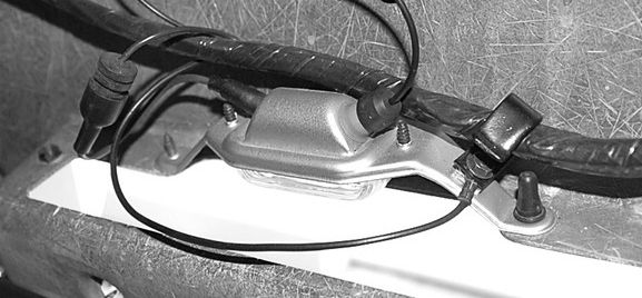

            Hi Bill,
            I recognized the finish on the housing to be similar to that on the tail light housings too.
            Also, there is typically a plastic plug on ONE of the housing mounting screws.
            It's the same part seen on the screws that mount the headlight plastic shields to the front bumper.
            Does your car have one?

                Hi Bill,
                HI Alan,
                First time to see an actual plastic plug. I saw the plastic plugs called out in the AIM. Mine did not have any. Now I am really curious about the plugs and if the factory put them on the headlight shields.
                Great pics as always.
                Bill
