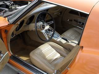

                      416 is indeed the medium saddle deluxe interior. That means there should be wood grain inserts on the door panel and the centre console. Carpet should be cut pile with matching trim pieces on the lower door panels.
                      Here's more or less what this colour and config looks like- ignore the incorrect mirrors and missing stickers on the door.
