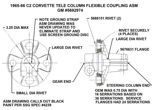

I have found another bit of information on the flexible coupling drawings.
5690809 was the standard column flexible coupling assembly it was used on the original C2 Vette in 1963 thru 1966. The engineering release date was 12/21/61. It never had a paint note.
5692974 was the flexible coupling assembly for the telescoping steering column (1965-1966). It was released for production on 9/17/63. It does have a paint note which reads:
"1. Paint assembly with SSG Code #4239 (Black) or equivalent. Paint in serrations and tapped holes must not be detrimental to function or assembly of part."
In reviewing the drawings for all of the flexible coupling assemblies that were used on Corvettes after the above, (1967 through 1982) none ever had a paint note.
Jim- Top
