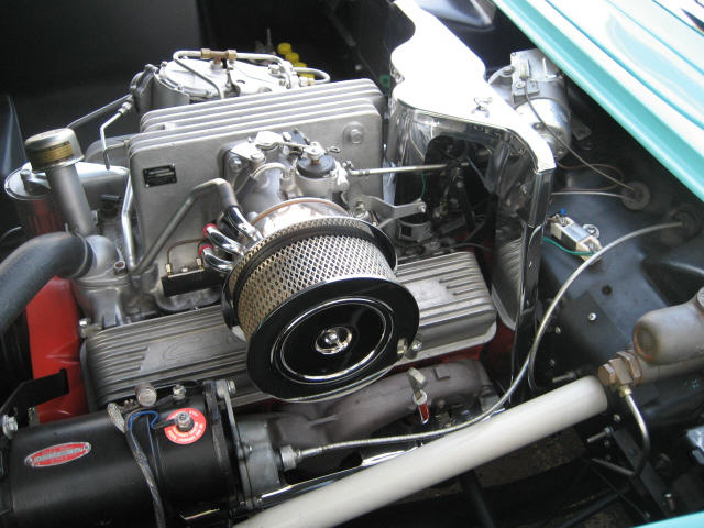

i just have to say..those are some beautiful pics of those engines! i always admired these fuel injection engines but since i now own one i have gravitated to loving them. i cant wait till the roads melt here so i can drive mine for the 1st time.- Top
