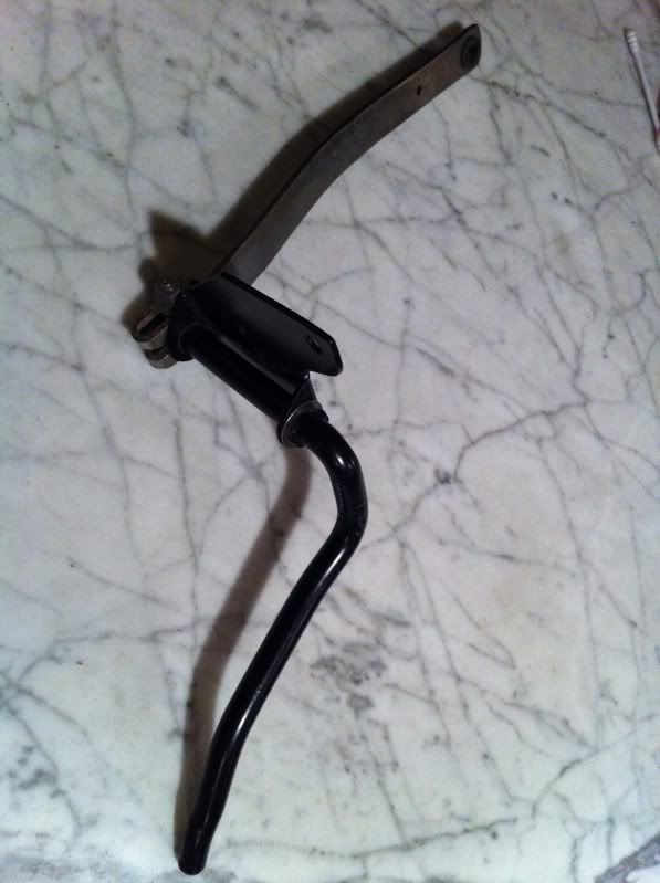

    Hi Guys,
    Here is a picture of what I am pretty sure is the gas rod from my 57 # 1851. It is the gas rod I removed from the car and restored for the 57 resto.
    Which end am I supposed to I.D. to find out if it was originally a gas rod from a fuelie or not?
    Is this a gas rod from an original fuelie Corvette or not?
    I don't know if you can tell from the picture, but the black end is definately round, obviously the raw steel side with a hole and rubber grommet going through it is square.

    Not from a fuel injected car. An FI throttle linkage would be round with the very end where it connects to the carb linkage flattened.
    I'm sure someone has a picture of one and will post it soon.

            Thanks a bunch guys!
            This is actually great news, as my car is a dual quad and I am pretty sure the engine is the original... so I would have been confused if the car would have had the fuelie linkage on the gas rod.
