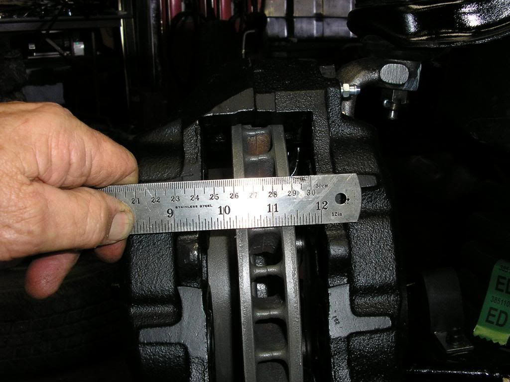

                      I have done some more checking on the brakes. I have 1/2" on one side and 3/4" on the other side. The brake pads are 1/2" thick, the 1/2" pad will not go into the 1/2 space, it is just to tight. So I got the old pads out and found one that was .470 and it fit in the space, so I cleaned up the old pads and reinstalled them. I am going to try to insert a picture, I don't know if it will work or not. Thanks to all who helped me . Terry

                        I agree with Mike. I'd say the root of your problem involves a bent caliper bracket. Even if you could get the brake pads in, the bent caliper bracket will cause other brake performance problems. I'd replace it.

                          You can put a washer between the mounting bracket and the caliper to space it inward. once the pads wear a little you can remove the washers. It is not likely that the mounting bracket is bent outwards. I have had a similar problem, it may be that the current pads are a little thicker than those in the past.

                            The front caliper brackets often bend in such a way that the caliper pad slot is "crooked" relative to the rotor. This causes the space between the caliper and rotor at one end of the slot to be different than at the other end of the slot. That, in turn, cause the pad to not fit into the slot at the narrower end. Even if one is able to get the pad in the slot by whatever means, the pad will subsequently wear unevenly. Can the bracket-to-caliper interface be shimmed to correct this? Yes, it can, but it's not the way to do it right.
