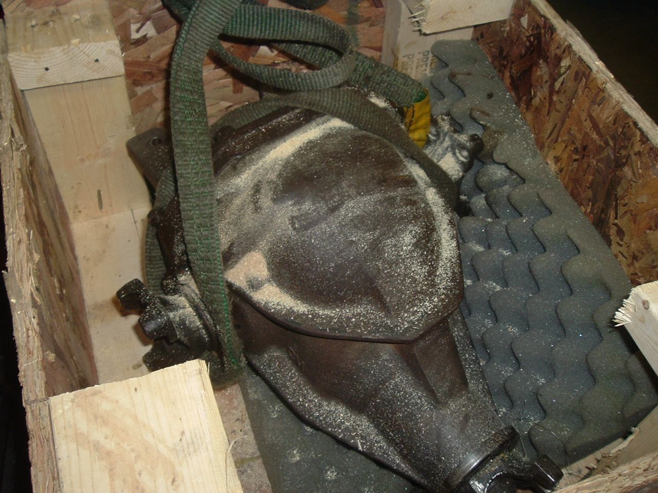

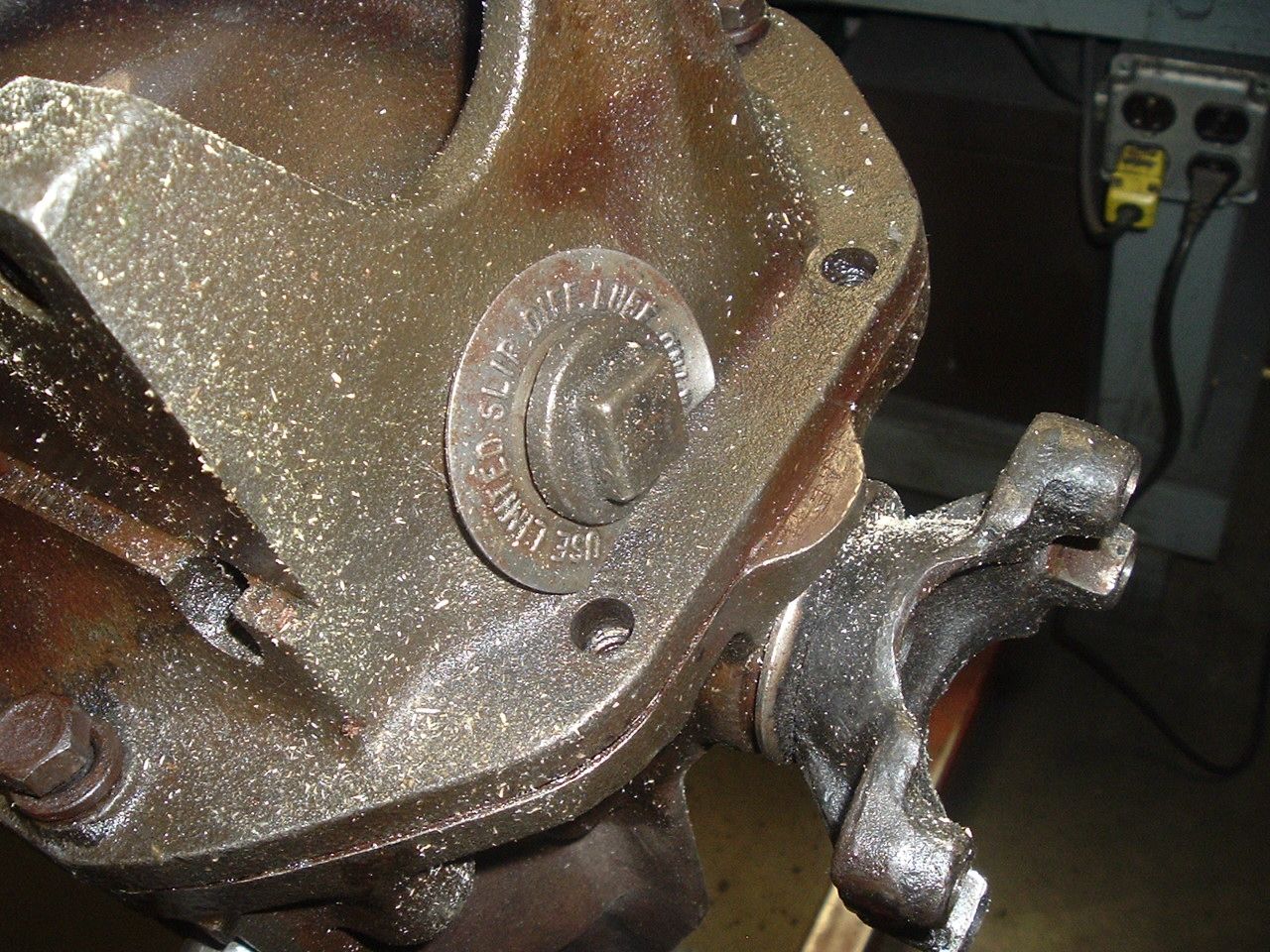

    Here is a '63. It will bolt into any vette from 63-79 although in stock form is not recommended for most applications.

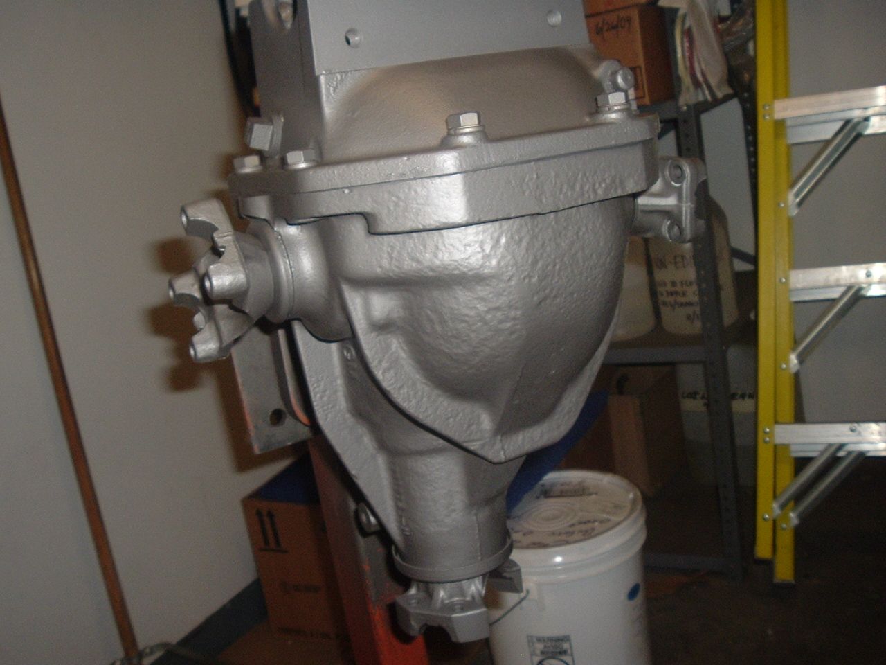

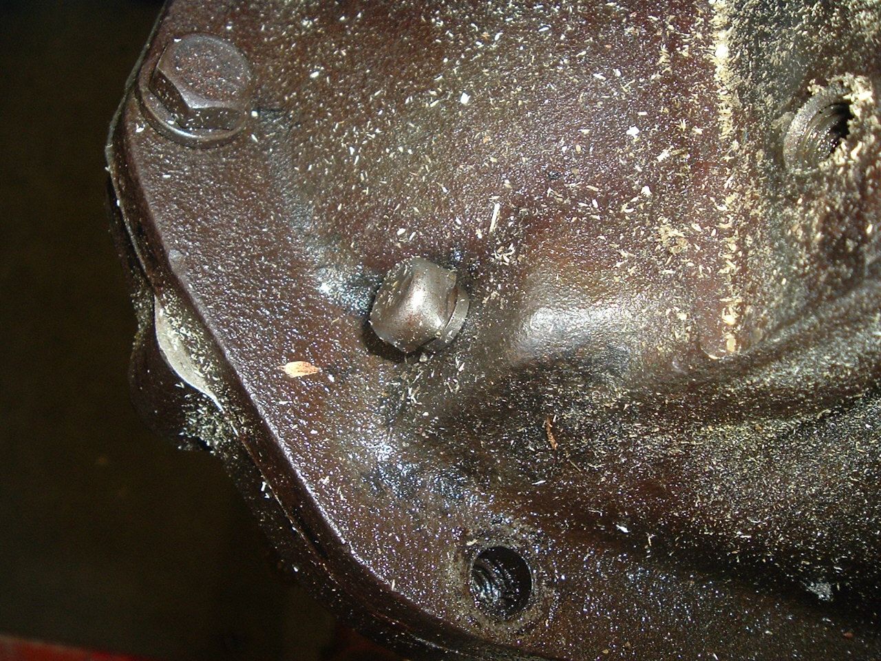

    The covers didn't have a date code like the later covers do. The side plug is larger and has a machine thread. The later covers use a 3/4npt thread. The vent is steel

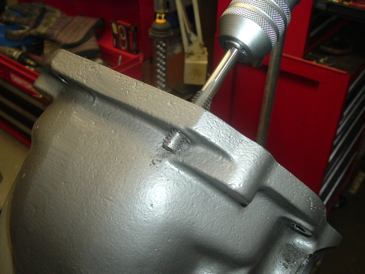

    The top casting has through holes because it's thinner. This is a 63

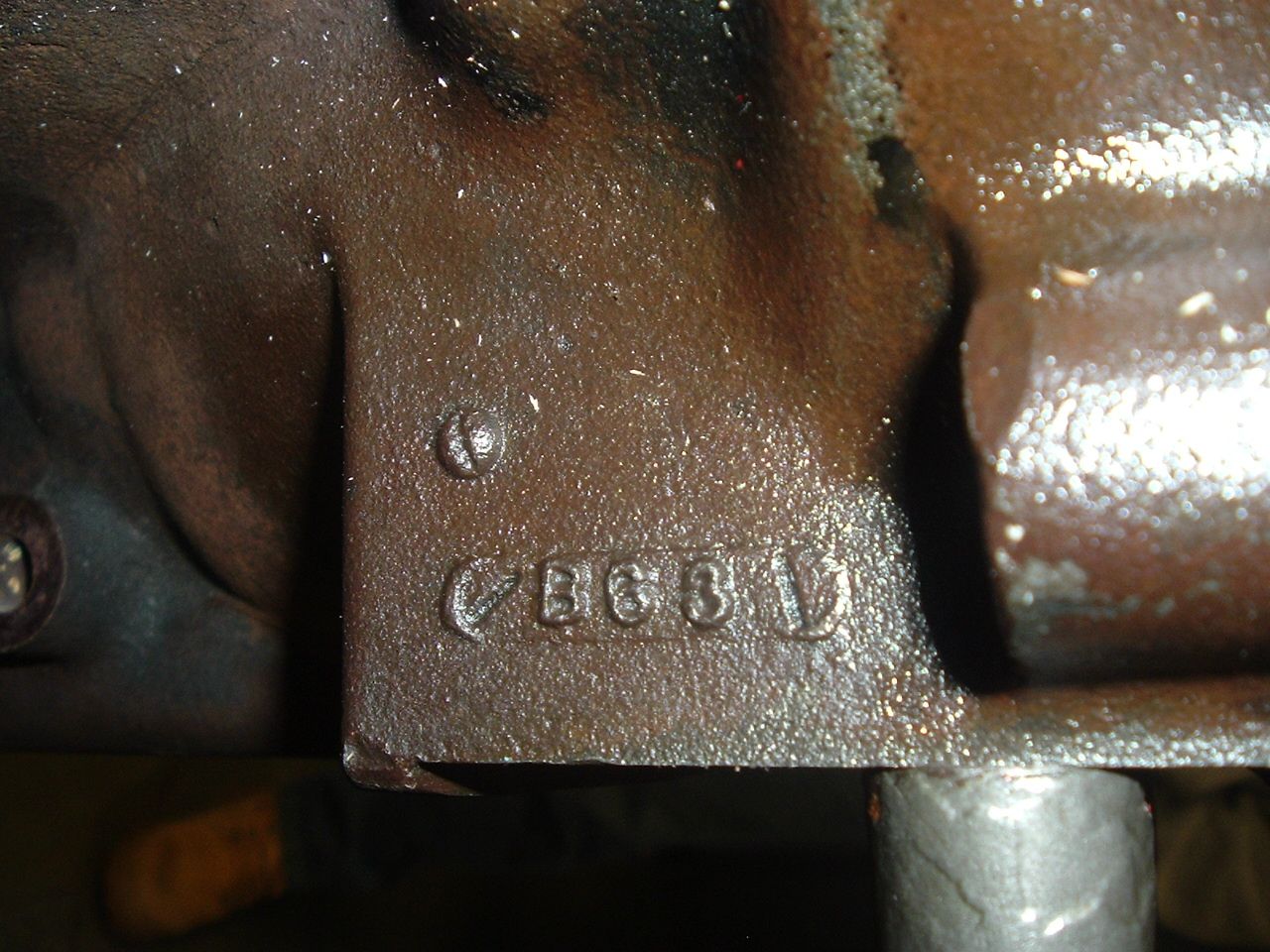

    Here is a 64
    casting date on the LH side

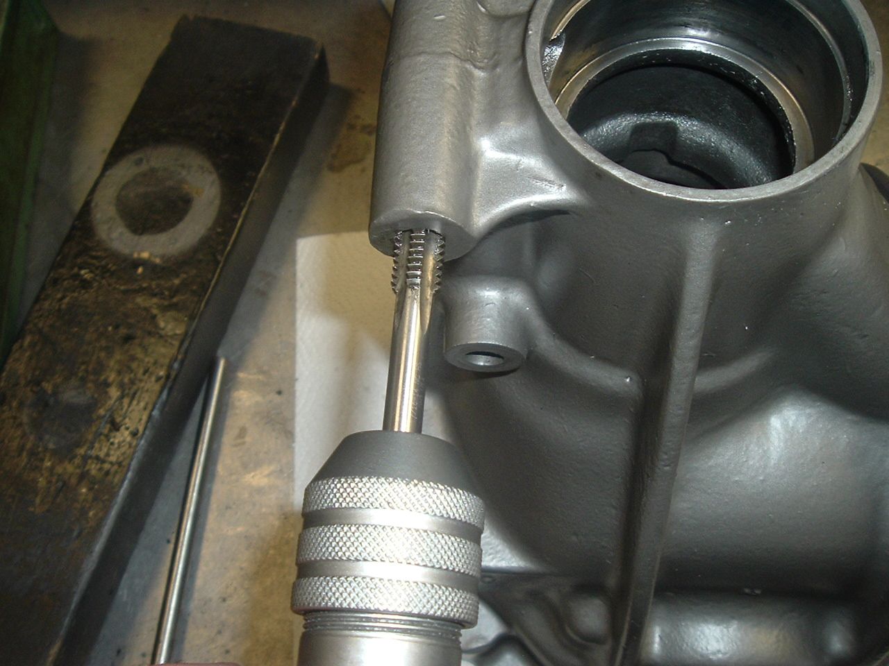

    The front bracket hole is tapped 7/16-14, 65-79 had thru holes

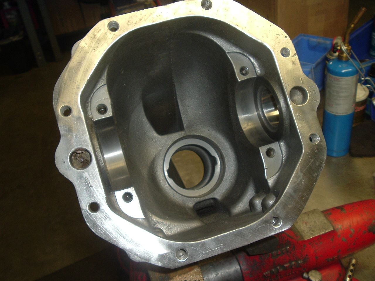

    Inside the spreader holes are large on both sides. The later housings have 2 hole sizes.

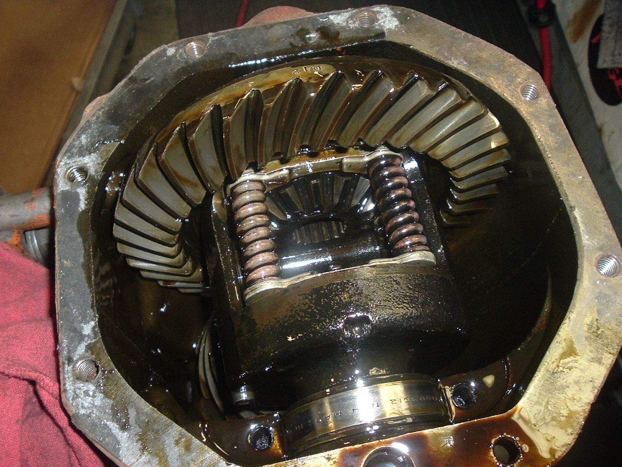

    Here is an original Dana posi in a stone stock 64 I did. You can see the difference if you compare to a 1st or 2nd design Eaton posi found in the 65-79's. BTW,the 65-68 Eatons weren't much better in stock form,most I see are cracked.
