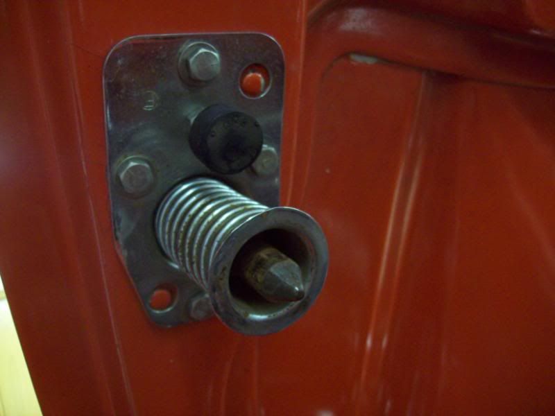

          Re: RE : 56/57 hood lock assemblies
          Here's one of the pins on my 56. Yes, it's been chrome plated---------------along with most everything else on the car!
