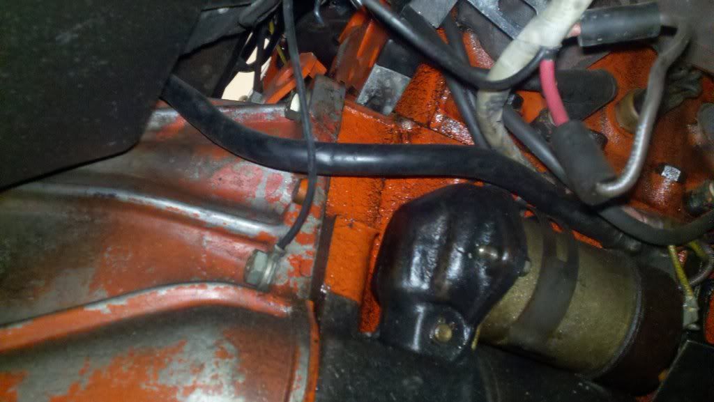

              This may help or not..but this pic is of my 73 in the garage..its a stick also..the one black wire is loop ended and grounded..http://i1216.photobucket.com/albums/...ket_35003_.jpg

                Rich, That helps alot. It makes perfect sense now that I see in the photo it's attached to the bellhousing bolt. The wire on this one wouldn't reach the starter bolt, where the ground normally attaches on most midyears.
                Thanks much......Rich

                  I think that wire does something with the wiper motor..not sure..but a friend of mine put a clutch in his 71 and he hooked up that wire onto the starter solenoid..it melted a bunch of stuff up on the firewall..glad this pic helped..
