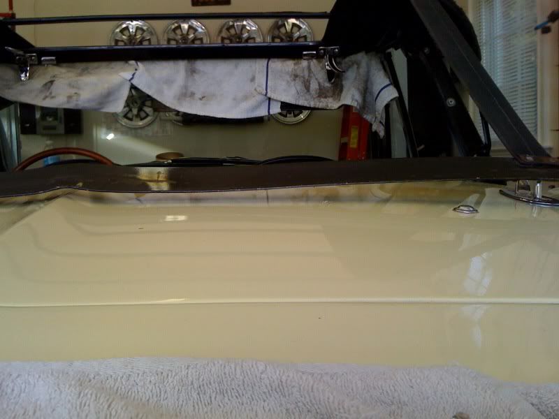

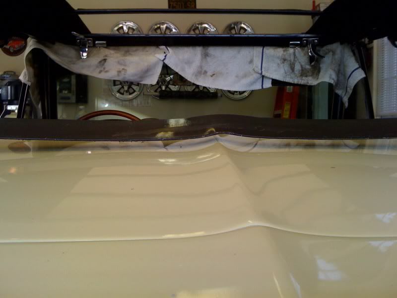

    I have decided to install a new soft top myself, and have read the archives suggesting that the frame must fit perfectly before installing the cover. My old top did not fit real bad with the exception of the rear bow. The rear bow fit very tightly in the center of the deck and would not seat to the deck at either side. I have searched the archives for awhile and can't find what I need.
    I have attached 3 photos showing that when the center of the rear bow is about 1/2 inch from the deck, each side is up about 1 & 1/2 inches. Is the rear bow likely bent, and can it be bent back to fit better.
    Is there a measurement I can use for the straps between the rear bow and the tack strip?
    I am using the installation instructions from Rowley Corvette. Any information is very much appreciated.

      My problems with the Corvette are getting the bows right. I see a lot of cars with the rear bow way off the rear deck, and mine was that way with the old top.
      I think I need measurements for the top straps, and then the dimension between the header and the middle bows. Right now the rear bow measures 16 1/4 inches from the tack strip, seems to me if I lengthen the straps, I can get the rear bow closer to the deck. Then I would like dimensions between all the bows, so I can be sure they are right, or change them when I install the new pads.
      Do you have measurements from when you did yours?

          Allright we are making some progress! I have an Al Knoch top kit with pads, and just went back out to look at them again. I found the markings, I just hadn't opened up the pads and removed the foam before, so I didn't see the chalk marks on the inside. I havent even removed the original pads yet, just the top cover.
          When I opened up hte new pads and layed them over the top frame, it looks like my number 2 bow is too far forward by about 3/4 of an inch. That would also raise the rear bow up off the deck as well.
          Now if I can get some help on the rear bow and straps I can get this project moving again.
          I have looked at the pictures I posted and looked at that rear bow again, I am convinced it is bent, might pull it off in the morning and see if I can reshape it to fit the deck better.
