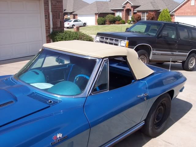

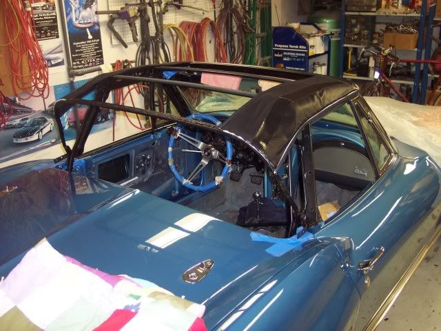

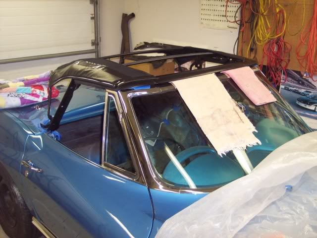

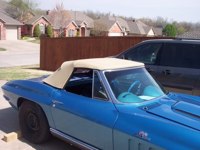

                        Ok, one more update. The top install is mostly complete, all except for the Header bow windlace, and working out some wrinkles with the heat gun. It is pretty bad behind the drivers side glass, but the passenger side is about perfect, and the rear window is wrinkle free. I have posted some photos of the results.
                        I spoke with Al Knoch today and have ordered the new windlace which is longer and has tapered ends to allow it to be tucked under the top at the corners. I enjoyed talking with him, Al is very down to earth, and apppreciative of his customers. Wow talk about customer service. As a side note Al said he may start shipping the alternate windlace, but he also acknowledged that it does not seal as well as the one he currently includes in the top kit.
