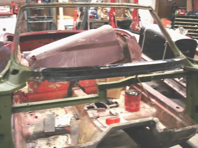

      I've got trim off, but no windshield installed if that helps at all.

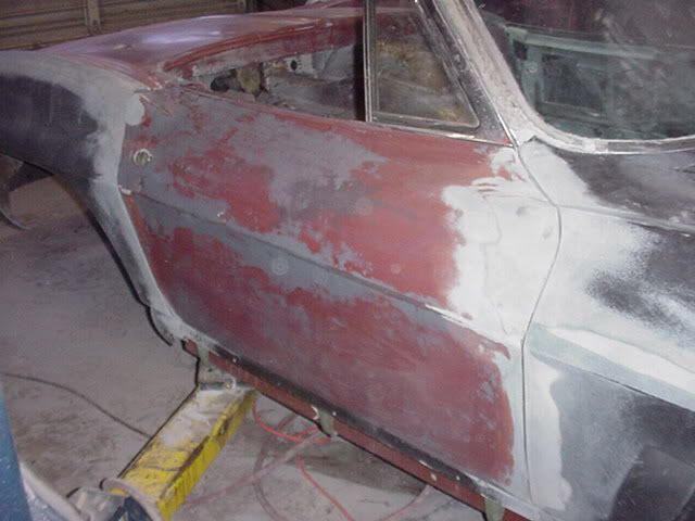

            Wayne, thanks for the photos, I'll copy and save for reference.
            Scott, thanks for the offer and if you could shoot me a nice close up of the lower corner and e-mail it to me , I'd appreciate it.

              Sent you these three photos. A problem area I had with my car is the inside corner areas were rusted through and I had to cut and weld in some new metal. I think the seal between the windshield frame and upper surround bonding strip goes bad which allows water to pool in these little box sections.

                  Thanks Scott. I think that will do the trick. I think I can take it from there. When the windshield was out for replacement and new rubber a few years ago, the guy putting it back apparently did not get enough caulking/sealant within the rubber and I have this small drip. This does not happen all the time. When washing the car I'll lay a towel on the floor. Sometimes it is damp, other times dry. Go figure !
                  I'll try the dish soap idea. Then goes the glovebox, and if I can narrow the field, then the trim will come off for more caulking/ sealant.

                    Re: HELP NEEDED Windshield Photo
                    NOW THATS A GROUND UP! Phil 8063
