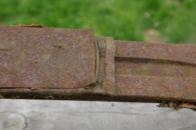

            Joe,
            When I took my springs apart, I don't recall finding the metal clips, but I did find, what I believe is, evidence of them being there. In this picture, you can clearly see that something was clipped on the end of the liner.
            I saved what is left of the originals and I'll take a look to see if I have any with the clips still on them.
            If you go to page 3 and 4 of the photobucket link in my signature, you will see a bunch of pics of my springs as removed from the car.
            Tom

              Re: 1960 Leaf Spring Clean Up
              Great photo Thomas. It looks like there is a clip across the end of the liner in your photo.
                Joe,
                I just looked at the pieces I was able to save and at least one of them still has the metal clip on the end.
                Due to some ordering mixups on my end, I ended up with two reproduction kits, one from CC the other from Paragon. I used the CC one as it arrived first, but the Paragon one may be a bit closer to the original configuration from a liner material perspective. Both are quality reproductions though.
