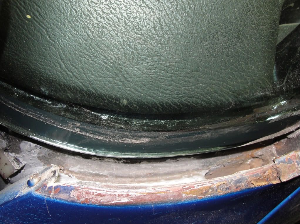

    I just got through digging the hardened caulk out from between the fender tips and lower windshield frame. After getting as much caulk out as I could reach I took a dremel tool and ground off all surface rust. A coat of rust inhibiting primer and paint coming next. Very tight quarters in there...
    Does anybody know what to use to refill this area? The caulk which I just dug out seemed more like a water collector than anything which would help. What did the factory use?
    Would some form of butyl caulk be appropriate? Where would I find it?

      The seam sealer is a bit stiff for filling in this area? I used some to seal seams where panels meet or panels or are rivetted to the birdcage. The original material looks a bit like gray caulk which was packed into the area. Problem I have with that stuff is it tended to become a water collector since it didn't seal well to the birdcage. I was thinking something softer, more compliant would work a bit better. A bit like filling with silicone caulk?
      This is one of the common rust areas on C3's. I'd like to see it never happens on mine..

          I'm looking for something which will remain a soft, elastic, and stick to the painted surface as well as the fiberglass. I'm not concerned about painting over it since the original caulk wasn't painted or if it was, having the paint stick wasn't a concern.
          Which 3M sealer are you using? Do you have the number?

            I'd use 3M StripCalk, which is probably what was used 40 years ago when the car was built. Waterproof, flexible, moldable, you name it.

                  That's a thought if I were to go with the closest material to the original. Thanks. I was hoping to find something I could apply with a caulk gun. Something which will fill the area, remain soft and sticky enough to seal up the area. Issue I have with the original caulk is it seems to form pockets which catch moisture between the caulk and steel.
