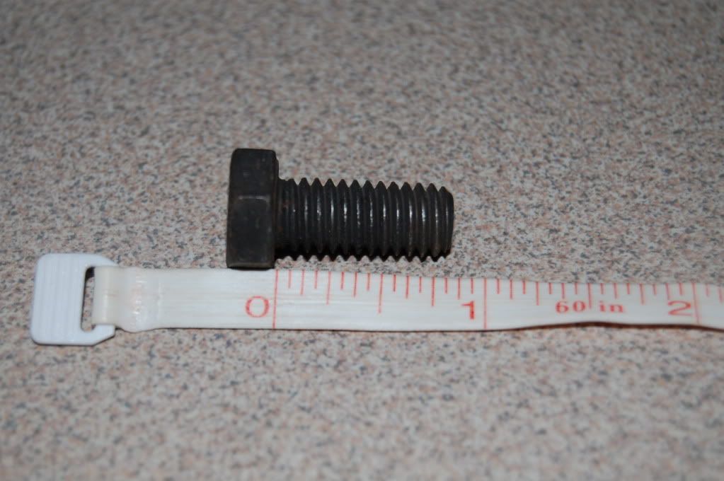

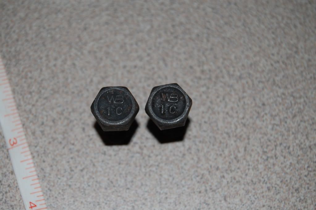

    I have two of these bolts. The WB 1C head mark seems to be fairly uncommon and the only other bolts i can think of on the 66 that have this headmark, are the long front sway bar link bolts.
    Again, i think these might possibly go to the transmission mount bracket.... The bolts that pass through the bracket and frame tabs to secure the it in place???
    Im sure somebody knows what the correct head mark is for those bolts, so if you can confirm the markings, then at least i could play process of elimination.
    Thanks

    a few possibilities here. They look like 5/16-18x7/8" if thats correct they have at least 3 possible applications on a C2

    WB 1c is not as common on a 66 as a 63-65 it is still possible for this.
    Other posibilites are M35

      Here's my WAG. It looks like the one of the headmarks I've seen on bolt p/n 122123. That was used to attach the Fuel Tank Support to the frame and the Spare Tire Lock Bolt Bracket to the frame and there are probably other applications. Pete

        Petes right if it's 3/8-16
        Forgot another application if its 5/16-18 rear muffler hanger to frame and to muffler bolt.

              In addition to the length shown in your pictures, the thead size (e.g., 1/4-20, 5/16-18, 3/8-24, 7/16-14, etc.) would be most helpful in trying to identify a particular bolt.

                That's a head mark that Chevy used for years. I have some that look just like your two on my '53 Chevy 5 window pickup truck.

                  122007's on rear exhaust hangers for 66 - RSC. These look to be the bolt Pete indicated, 3/8. WB1C other than the front sta bar long bolts was rare, rear tire lock.

                    Found the location of these bolts thanks to my father's 66 that i replaced the gas tank on 3 years ago. His car was from the North and i actually had to cut one of the bolts off. Two of the other 3 were so rusted that the headmark was no longer distinguishable, but, one clearly has the same headmark and is the same thread size and length. I would have thrown the bolts away, but they fell into the trough on my lift and i haven't cleaned it out in 3 years.
                    So, this particular WB1C bolt goes to the Gas tank crossmember. Apparently i am missing two of the bolts, sigh.
