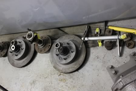

                    Re: Started restoration of my 67 vette
                    Here are some update photos of the restoration in progress.

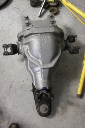

                    • Michael P.
                      • March 2, 2009
                      Here are a few more pics.
