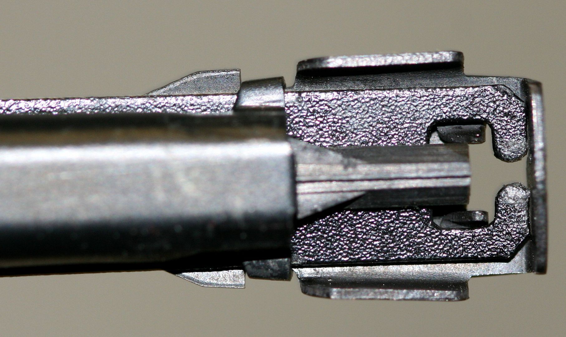

        It has what I would call black goop coating. That is to say I'm not sure what it is. I apologize, this is a bad pic so I'll try to get a better one later...

              Here is a pic of the previously mentioned goop...

                I have a pair of original 70 Camaro SS350 18" black chromium Trico wiper blades with original rubber inserts (assume to GM # 8798506).
                The rubber inserts have "U.S. PATENT 2697241" molded on the rubber. The metal reinforcements are dull black with 29 "loops".
                I also have several sets of NOS Trico RF-18 inserts (aka refills) that have the same "U.S. PATENT 2697241" molded on the rubber but the metal reinforcements are plain metal with 29 "loops".
                I have a pair of satin 16" Trico blades removed from a 1970 Pontiac LeMans convertible ("LT" on glass = May 1970) back in the early 1990's. The plain steel reinforcements have 25 "loops" (24 small, 1 large) and still have remnants of the rubber insert.
                I have a pair of NOS 9872322 18" black chromium wiper blades (first used on 1971 models) that are the same as my original 70 Camaro SS350 blades mentioned above EXCEPT that the dull black reinforcements do NOT have the "loops". GM # 9872322 replaced GM # 8798506 in Aug. 1971 as per Chevrolet Parts History.

                  Mark,
                  I have collected hundreds and hundreds of Trico wiper blades at junk yards and swap meets over the last 30 years and have never seen any wiper blade reinforcements with the "black goop coating".

                          Here are some not so great photos. The black on the NOS 9872322 (1971 vintage) reinforcement seems to be very fine "goop" unlike the 1970 dull black reinforcement.
                          Dave

                            Those are excellent pics!
                            The pic I took of mine is with a high powered lens which probably shows too much detail. I believe the coating/finish on yours is the same as on mine. I'll take a pic of mine with another lens tomorrow which may compare similarly to yours. I guess my point is, it isn't a phosphate or typical painted finish. Perhaps 'goop' just doesn't adequately describe it.

                              The "goop" on my NOS 1971 blade reinforcement is hardly noticeable. You really have to look closely. I did not notice it until I took the photos.
