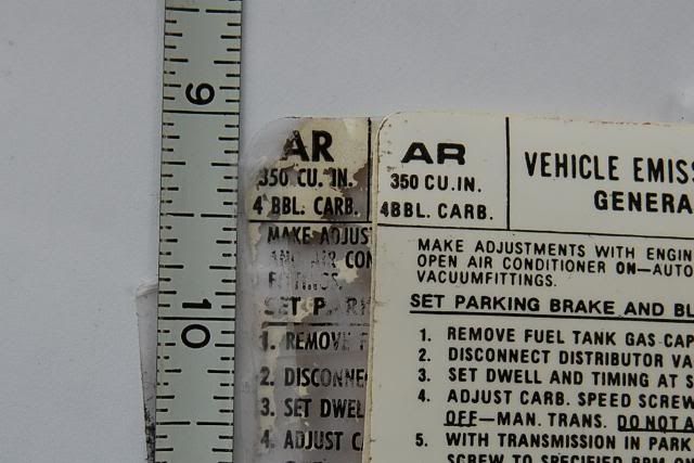

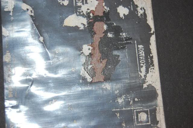

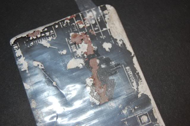

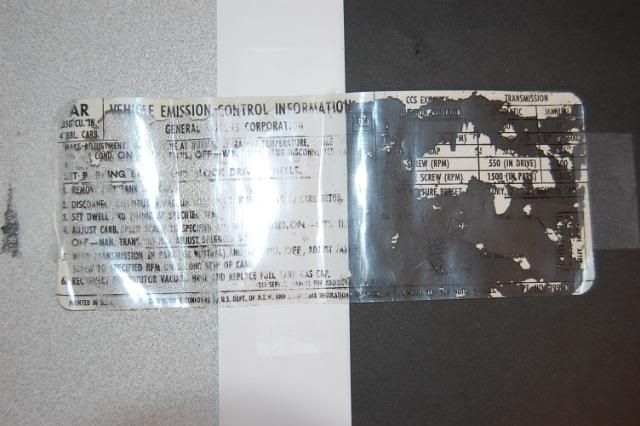

        Hi Don,
        Good to talk to you!
        On my 71 the label doesn't appear to have any paper in it, just as Joe stated.
        Going from top to bottom it appears to be: the clear 'glossy' (as Joe said) plastic, then the black ink (it stayed on the plastic as I peeled the label off the car), then a layer of white, ( some stayed on the label, the rest on the car), then a layer of black (most stayed on the car but a bit on the label), and finally a layer of grayish silver (most stayed on the car).
        I'm thinkng the 'vinyl' (plastic) label you mentioned will be fine.
        Here are a few pictures but the gloss wants to cause havoc with my lens.

          Alan,
          I suspect the black material is the black out paint.

                Hi Don,
                I took a look at my label with a magnifying glass and I believe Terry is right. When I flicked some of the gray layer off the black layer low and behold there was body color.. red. So, what I listed beyond the white layer was part of the car, not the label.
                The reproductions... I've been disappointed with the various examples I've looked at over the years. The information is there but the lay out and fonts vary quite a bit..... at least for my 71's AR label.
                Perhaps you'll have better luck with your 72 label. There may be a much better reproduction labels out there. They're only a few $ so you can order some from various places and see what you get.

                  Thanks for the photos Alan. The color in your original decal appears to be an off white vs bright white. True? The one on my car is not quite white and the reproductions I've seen look to be VERY white, which discourages me. When I saw the difference in color, I stopped and didn't even compare text or font in a new one to what I have. The judges at last summer's national meet didn't seem to mind mine missing the inboard 1/8" or so, therefore, maybe I'll just leave it alone.
                  If I can find a great reproduction decal, I'll probably use it. Would you please tell me what the overall dimensions of your original are?

                      Hi Don,
                      Yes, the original isn't as bright a white as the repros. Age? Heat?
                      The label from my 71 is 7 1/2" x 2 1/2".

                          Hi Don,
                          Age and heat would be my bet. Just like a lot of other plastic parts in the engine compartment.
