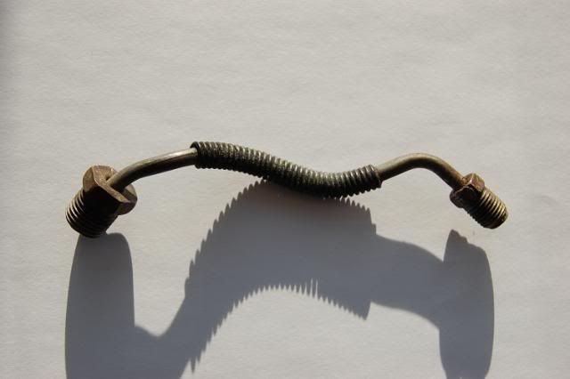

        Here's a picture of the short brake line frm my 71.
        The armor is about half the length of the line and pretty well frozen where you see it.

              The originals armor spiraling looks 'thinner' with more coils, than the replacement. Same overall length though. Not knocking it, just a casual observation!
