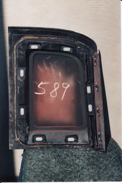

    When I restored mine I didn't see any date codes. But since some interior panels, like the door panels have a date stamp, perhaps some did?
    I did find this however... the last 3 numbers of my VIN sequence. (not the job number) The body color is red
