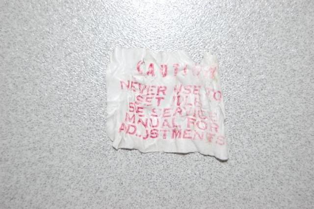

    The part number for the solenoid is 1114444 and there always 4 or 5 of them for sale on fleabay with varying prices and cosmetic appearance.
    The red on white stickers on them are very detectable as repros, as opposed to originals.

      I'm curious how many versions there were of the labels before the reproductions started?
      I bought what I think was an over-the-counter part. In the box was a solenoid with a label, a loose label on a waxed paper backing that appears to have been cut from a roll (the label looks like it melted), and an instruction sheet, (note the date), showing a solenoid with a label. The 3 labels are each different from each other.

        I think there were 2 style of labels the original version wording goes length ways with the cylinder and the later service label the wording went around the cylinder. As far as the date on the instructions even a solenoid made say 1980 could have the 1970 date on the instruction. I have seen that many times on parts with instruction that the date is when the paper instructions were written not when the part was made per say.

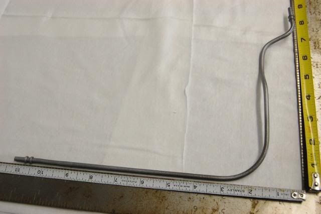

              Anyone have a picture of the metal vacuum advance line tube by chance?
              I have one with the clip, but it looks like it's for a '70 where the line goes into the solenoid from the front instead of straight across the front of the carb into the side of the solenoid. Easily fixed, but I'd like to see what it's supposed to look like.

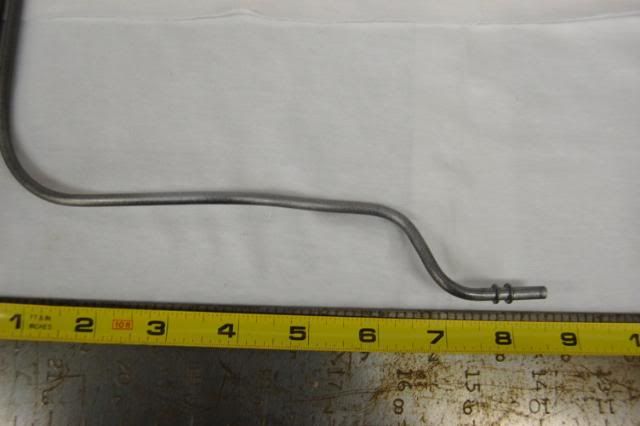

                Here's a picture of the steel line from my car. Note it has the 2 ribs a each end.

                  The metal vac advance line is connected to the vac can & solenoid via short rubber lines.

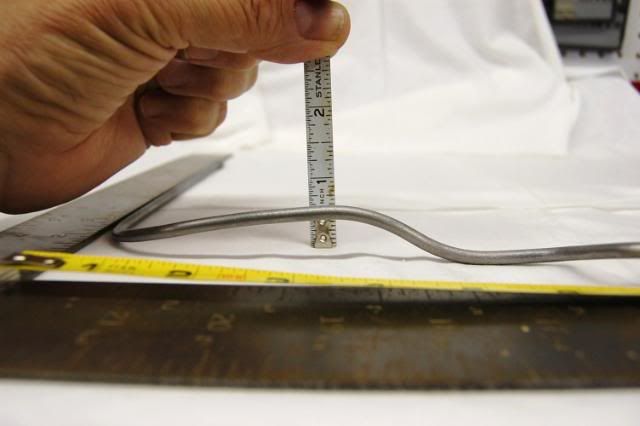

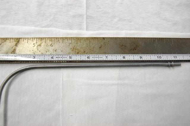

                    Here are the two styles: early on the left, late on the right, GM replacement in the middle.P4280896.JPGP4280899.JPGP4280900.JPG

                      Thanks very much for all 3 pictures!
