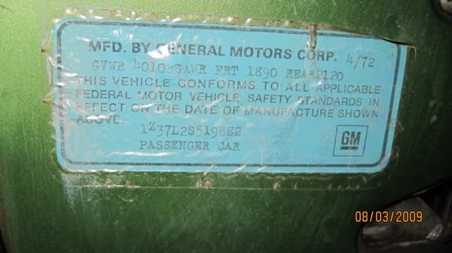

        • Roy V.
          • April 8, 2008
          • 296
          Re: 1972 LT1 Coupe GVWR Needed
          This is a label from Bryon's car (hope you don't mind me posting it)
          72 LT-1 coupe with air
          Regards
          Roy

            This label was on a car that was stated just before Christmas and completed after the New Year. Very interesting on all the changes on this label 2 dates different font for the VIN among other items.
            • Reba W.
              • 932
              Since the GVWR was added in January, GM obviously didn't have the process refined.

                          • Roy V.
                            • April 8, 2008
                            • 296
                            Just to clarify, the label in post #5 above is from Bryan Montford's 1972 LT-1 (I believe he has since sold it) it is a C60 a/c coupe and I don't know if he had power steering or power brakes.
                            GVWR is 4010
                            GAWR front is 1890
                            GAWR rear is 2120
                            Versus
                            MY 1972 LT-1 coupe, non A/C, with P/S and P/B
                            GVWR is 3910
                            GAWR front is 1810
                            GAWR rear is 2100
                            • Bob P.
                              • June 30, 1998
                              • 143
                              Thanks Roy. You essentially have the same car as mine. '72 LT-1 Elkhart Green Coupe with P/S & P/B no A/C. It has a saddle interior. I will use your data to make my certification label and use Bryan's font and layout since it was produced at about the same time my car was.
