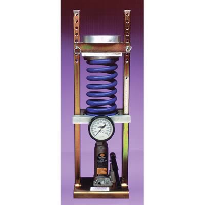

              Thanks Tim!...They have some rust...Not really too bad...I can media blast them so I'm not worried about appearance. The ride height seemed right. I found this post from John Hinckley in 2005.
              The free height of the original 3851100 spring was 16.82"; however, the free height measurement is pretty meaningless. Springs are rated by working length at design load, which is 9.98" at 1340# for that spring, with a load rate of 195# per inch (at the spring, not at the wheel) at that design load. Springs generally only lose design load rate if they've lost material (effective wire diameter) due to corrosion.
              I measured the free height and they were very close to what John posted. However as John pointed out the rust could effect the rate...Could something like this be used to test a spring?
              Free Shipping - Rebco 260-8620 with qualifying orders of $109. Shop Coil Spring Rate Testers at Summit Racing.
              Mike
                • 15573
                Re: Coil springs on a 1964 Corvette natural/unpainted finnish or painted?
                Sure it could, if you have one. Many, many moons ago when I worked in a metallurgy laboratory we had a similar, but more sophisticated, device that would do the same thing = measure load under compression.

                    With 1340 lbs of force on the spring, I'd highly recommend some sort of adequate containment mechanism, just in case your load is a little off center and the spring decides to scoot.
                    Gary
                    • Mike E.
                      • June 24, 2012
                      • 920
                      Originally posted by Gary Beaupre (28818)
                      Mike,With 1340 lbs of force on the spring, I'd highly recommend some sort of adequate containment mechanism, just in case your load is a little off center and the spring decides to scoot.Gary
                      my 20 Ton Press using a beam type load cell like this and probably get better results. Might be a fun winter project.
